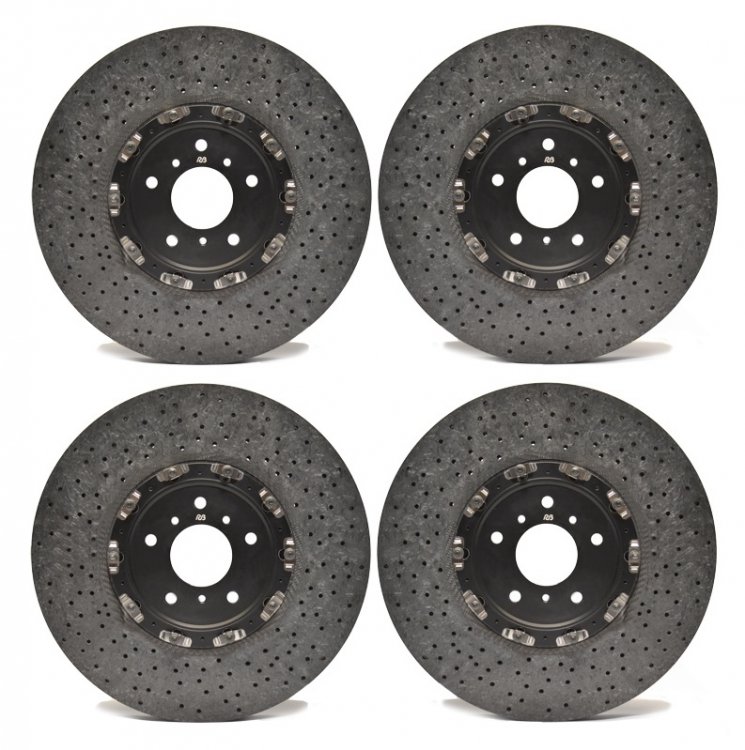

Pour alimenter le forum, suis tombé sur ceci aux US
http://www.racingbrake.com/RB-CCB-Rotor-Kit-394-390-for-Ferrari-F458-P-N-2-p/fer-crk-01.htm
Uses same CCM disc as Corvette Z07/Camaro Z28 so replacements are readily available and more affordable compared to other carbon rotor options.
RB rotor hats are made of forged (vs. billet) aluminum for better strength and rigidity.
Rear rotor are of composite hat: lightweight aluminum shell with an iron ring insert for significant weight savings (about 50%) than made of SS or iron like OE rear hats,
while still retain the use of the emergency brake, unlike other aftermarket light weight hats just cut from aluminum and must delete the OE emergency brakes. This design is exclusively available from RB Performance Brakes.
